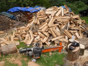

I use a electric 4 ton right now and it is very very powerful and splits all but the biggest stumps it also is two stage.
Two stage is a life saver!

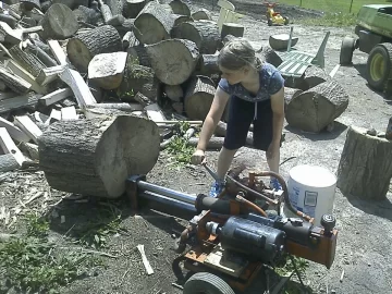

Regency139 said:My 8 ton Brave EZ-Split has taken care of anything that i can lift/roll onto it. It can split a round up to 18"
