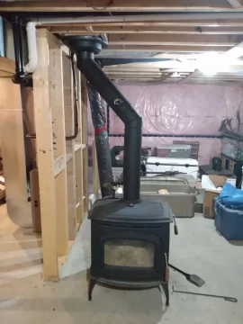

Duke01, can you describe the entire flue setup including any elbows, tees, etc. from stovetop to chimney cap? Is it straight up with double-wall stovepipe or out the wall and up?

So she goes right up inside the house around 20 feet from there. Double walled all the way. I found little pieces of black tissue paper looking stuff on the snow afterwards. I know my wood moister is low but it has me wondering if it needs more seasoning. However, I am questioning everything now. Thanks again guys.

Oh yeah, put some sheet metal between the stove and that wooden framed wall to the left...

He has a cat stove so no chemicals should be used.
His clearance to combustibles looks like it is within spec for that stove to me.

I'm still leery about the wall frame to the left...
I would use a IR scan gun to make sure it did not get too hot on that framing.

Because repeatedly overheating that wall MIGHT cause the studs to warp, deteriorate, or break down structurally, not just combustion risks.
I just checked my area with my IR gun.
Hottest part of stove, 435°F, Avg stove temp, 330°F
Draft almost completely closed, 2" bed of coals, freshly loaded three pieces of wood,
two red oak splits, and a 4.5 inch Beech log.(for the night)
It will EASILY take four times that much wood at once.
Block wall 3 feet away from 'cold side of stove', 105° F.
Hearth 125°F 1 foot above stove/pipe.
Planter with wet soil, 3.5 feet from 'hot' side of stove into open room, 96°F.
Floor 10 inches below bottom of stove, 118°F.
Ceiling above stove, distance 6 feet, 105°F.
I don't know what temp this guy burns at, but an IR gun from Amazon reads up to 1000°C for $16.99.
I would recommend checking the temp of that wall under average duty temp for his burn need.
The IR gun will give a good idea of whether it should be shielded, for the long haul.
I was just suggesting sheet metal, or shielding,
to be on the OVER prudent side.
