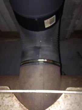

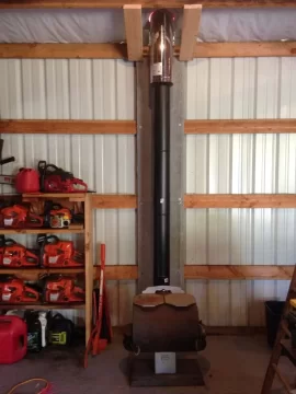

I acquired an Orley brand stove recently and thought it'd be perfect for the shop. Bought all the stuff to do the install and then realized the outlet is not six inch, or five inch. It's somewhere in between. I managed to make the elbow work by popping the rivets and slipping it over and using a clamp to secure it.

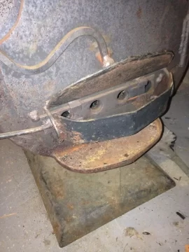

Now I've run it a few times and man is it temperamental. It seems it drafts real well because there is zero issue with smoke at start up and it takes right off. The scary part is after it gets hot and I start shutting it down it starts to puff and flame out the air holes in the air control on the door. The only way to remedy this is is to open the draft all the way which causes it to really take off or close the damper all the way and the fire just smolders. Any ideas what's going on?
