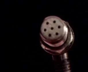

I would like to see you braise shut this orifice shut and redrill it. Bras casing with ceramic inside nat gas. sit group my stove avitar . ;lol
