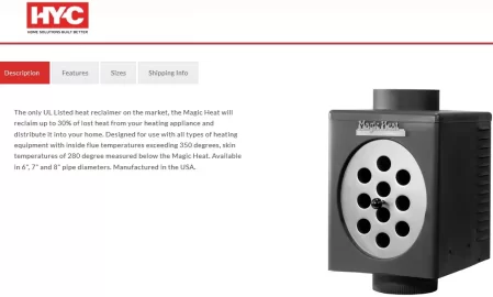

I am amused to note that if you Google for Fire Chief stoves, you'll find s a company in St. Louis called Hy-C. This company makes Fire Chief brand wood furnaces.
They also own Gardus, who make the Soot Eater which is so popular here. This becomes funny when you find out the next thing they make...
So the question is: Was the "Magic Heat" actually invented specifically to drum up business for the Soot Eater?
