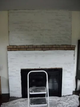

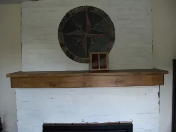

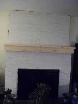

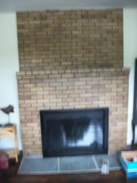

Image is not showing up. Not that tough to do Im sure I could walk you through it. Put up some pics before and during ( you have seen after). Please let me know and we will make you a tile star. Please post some photos. [Hearth.com] Need help in deciding which Pellet Insert to get in the new house we just bought [Hearth.com] Need help in deciding which Pellet Insert to get in the new house we just bought [Hearth.com] Need help in deciding which Pellet Insert to get in the new house we just bought [Hearth.com] Need help in deciding which Pellet Insert to get in the new house we just bought

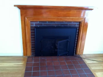

So keeping the wood surround and mantel is an easy area to do. The hearth is an old quarry tile. How secure are the quarry tile? If you tap on them do any sound hollow..would sound like tapping on glass.
Are you planning on doing the hearth? If yes the best way to do it would be to break it out. Is the hearth the same height as the firebox?

Yes, I wanted to do the hearth, and yes, the hearth is the same height as the firebox. So I would want to break out the hearth so that the new material I install will continue to be at the same height as the firebox?
Yes you would take out the hearth. Take a hammer and smack down on a piece. You want to hit down on the piece as opposed to trying to pry up from a side, this will rattle the piece and normally break them up easier. Keeping the same height should be easy. An older hearth like that will most likely be set in concrete which will need to be removed. It can be built back up with backerboard ( if needed). The good thing about slate is the thickness of both will be about the same, so getting the right height should not be tough. I,m thinking your hearth is appox. 56 to 58 " wide? Another thing about slate is it cuts very easy, though can break apart because of its nature ( wet saw).If you are ready for the challenge I will help you every step of the way. Have a few thoughts on a simple yet elegant design.
