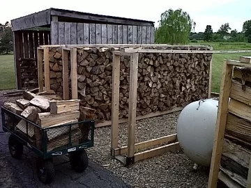

Like most here, I like to stack on pallets. Keeps the wood off the ground and allows air flow below it. Building a rack with pressure treated wood is probably better. Good luck.
I used Rutlands "Stack-N-Store" Firewood racks. there is a 4x4 on the bottom of the bracket and a 2x4 runner that the splits sit on. So before I laid down the River Rock, the wood was 7" off the ground.
As for when to split... ASAP. Get it split open now. The sooner the better. Wood does not season in "Round" form.
When stacking your "Rounds" (Yours are cut at 24", you said). Try and put at least a 2x4, 4x4, or a landscaping timber works well. I have some under each of the 3 rows of Rounds (The 2 Rows of Oak are split now) in the Pics. They are a little hard to see. But I can see lil bits of them.
Wood will rot if it stays wet (Most anyways). Get your rounds off the ground, get them split, and take some Pics of that beast when you get it installed.
Certain wood takes awhile to season. Oak takes at least 2 yrs, but 3 yrs is best. The Oak in my Pics is for 3 seasons from now. Ash, Cherry, Silver Maple, and Pine all season pretty quick.

Dexter, I am almost positive that every time you post pics of your wood pile there is another row added. You are just hum dinging right along.

Edit: Dexter's stacks are disgustingly perfect, & make mine look bad, as well as giving me an inferiority complex. However, despite the blow to my ego, that's about as good as it gets right there. He & Dennis & some other "masters" on here will help make wood burning a pleasure for you.

I feel that those wood piles are just only for decoration. The real heat source seems to be the gas tank hiding in between the stack. ;)

Thats my way of stickin it to the Man. He cant get to it, to fill it. Thats the Tank for my garage/shop. If you notice, the garage is VERY Long (Its almost 50x50) Its a 3 car garage, but the other half is a Shop. You can see my Pellet stove vent for the shop side in some of the Pics. I no longer need LP out there either. So they can take that tank, if they want it. The tank for the house is on the Far East side of the property/house.

Mike, wood needs time to dry properly. Also, the wood does not dry until it has been split because the bark holds the moisture in and the moisture can get out only through the ends. I've always recommended having 2-3 years wood supply on hand that is cut, split and stacked. That way you know the wood is dry and should some unforeseen calamity come unto you, you'll still have good wood to burn.
We are many years ahead on our wood so this is how we stack. Notice there are some saplings that we laid down and then stacked the wood onto. If you need wood to dry fast then it is best stacked in single rows but we have the time for drying so stack more than one row to a time. We stack usually around 4 1/2' high which will shrink to around 4' by fall (we split in March and/or April). We do not cover the wood until just before snowfall and then cover only the top of the wood piles. Never cover the sides or ends.
(broken image removed)
thanks dennis
great pics
like they say a pic is worth a thousand words
