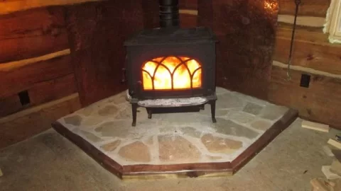

My Jotul is installed according to manufacturer's spec but that wall was getting quite warm so I installed the copper.
When I get back, even if it is a warm spring day I am going to fire up the Jotul and feel the wall behind the heat shield.
