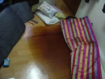

You don't want to move the stove and find this.

That sharp edge of completely different colors don't look like it was caused by a hearth pad. Unless some idiot built a campfire on on it. Cant fix stupid with r values.
It was a metal, ember protection only pan used for a stove that needed real hearth insulation protection. Some folks don't know the difference when they go online or to Walmart and buy a hearth protector pad.
Seems if it was from a stove there would be a center burn area much darker then gradually less burning towards the edges. To me that looks more like sun fade with the shaded area caused by a welcome mat or similar.
It is from a stove and darker where the stove sat.
so how hot do you think it got to discolor the poly on the floor.........I'd love to know what was there and what stove was there. If a stove was on legs and had air between the bottom of the stove and the floor protector would that cause this........subscribed to this one
This was from early days in a thread on pyrolysis. I don't recall much more than it being an older stove on a metal pan. I've no idea what temp the finish on the floor is rated at nor for how long the exposure was. Pyrolysis can happen at temps over 180F if sustained over a long period of time.
Looks like water damage along that one joint? Actually, looking close, that might be a sheet of vinyl or linoleum and not hardwood.
That's possible Highbeam.
