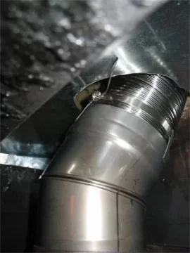

Had to look up "offset adapter box" as I've never heard of it. That may help with my install as well. Also noticed last night I may have to chisel out the chimneys damper frame. Not sure how hard that will be. It looks like I'll have to make the chimney pipe/liner into an oval shape to get it through the chimney's damper area if I leave the frame.
I'm a bit nervous about my wood supply. It's been cut/split/and stacked for about a year so hopefully that's enough time. I may also use a heavy steel chimney plate thing the previous owner left behind. I'm thinking about placing the steel plate behind the stove to soak up more radiant heat.

I had the exact same issues with the steel up inside (damper plate) I did just that kinda crushed the liner making it oval and passed it thru the restricted area. Probably not the best choice but it works and a brush passes thru no problem. I stuffed a bunch of roxul insulation up inside and made a 2pc sheet metal blockoff plate and installed it. I bought my NC-30 used and it did not have a blower. I installed a blower I had off of my old stove that I replaced. I have year old wood that I split into small splits. Its mostly cherry and maple and burns just fine. I found that it's important to get a good hot fire going first with kindle. For kicks I also bought a few packs of those fuel blocks from Tractor Supply and tried them. They burned very well also. I buy a ton of these on Black Friday. They are easy for the little lady to add to the stove when she get home for work and has things to do, yet keep the fire burning and the heat going for her

Nice. I'm planning on using the Sooteater to clean the liner. I have to say though, since you're a 30/wood heating expert, I expected your block off plate to look a bit more professional lol. I like the plate @mellow uses. Just have to figure out how to make it.
Get back to me after you work inside that fireplace with the stove in place connecting the liner. ;lol

Haha, BB is right, that is why I punched a hole in the back of my exterior chimney and put in a clean out door. When you have a tendency to switch out inserts like I do it makes life alot easier.
How did you make your block off plate?
