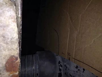

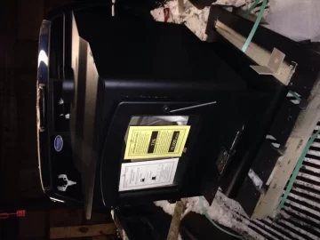

[Hearth.com] Nc-30 dimensions Beautiful sight right there boys. Now another pic shows a very rough template but it looks as if flue placement will be easy[Hearth.com] Nc-30 dimensions [Hearth.com] Nc-30 dimensions [Hearth.com] Nc-30 dimensions

Just a lil tip, if that's gonna be your only heat, do a burn-in out in the driveway. If you don't, your fiance will just "love" the house reeking of that new stove smell! ;)

Yeah I'll probably do a small fire outside in the driveway. You really think I should hold up and get that elbow? The rough template actually showed the stove sitting where I want it and it was lined up right next to existing oval pipe on our insert
Oh, well, if it looks like it's gonna line up then never mind me.

I double checked my rough cardboard template think we will be good to go once I cut damper and I'm going to try not to take any firebrick out of her! Can't remember if anyone answered but is roxul ok to be directly stuffed next to bare liner? Going to fill gaps between block plate and liner with some
Roxul should be fine. Is your liner gonna be insulated? There is usually extra insulation, you could use some of that to put right next to the liner.
If you have a diamond blade on a angle grinder you can make a nice lil liner shaped notch in the brick if it would help. Stuff cuts like butter with a diamond blade. Don't hesitate to remove brick as needed to make it work, it's really no big deal as long as you don't take the whole chimney down. ;lol
