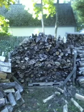

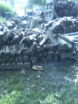

Here are the pictures right side up

davey-drying wood is a straight forward procedure, single rows in an open area is the best way to stack it, here in Iowa I dont have to top cover but thats up to you, I do belive single rows dont need to be covered as much as multiple rows, moisture gets inbetween the rows and takes longer to dry due to lack of air movement.

Well the wood definitely looks seasoned, so I would suggest that you sift through it all and do a lot of testing, some of it has to be ready to go, then I would restack it all properly..... You got your work cut out for you but do it now, sooner than later. Also while your doing that, re split the bigger ones, that will help also for the future

Davey appears from the pictures this is a damp area - neighbor's roof has a good bit of moss.
The "stacks" as they sit now are more piles and are not going to dry very effectively. It's hard to judge the amount of space you have and the layout/access points from the pictures.
If your stacking skills aren't there yet you may be best served by building a couple wood racks from some 2x4's and getting all the shorter stacks neatly spaced and about 5-6' high.
The lower parts of stacks will always be a bit more damp, and that's basically what you have now - a bunch of lower stacks in varying degrees of incompletion
