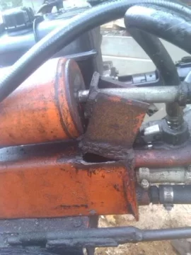

Well, I was splitting a cord of wood today and broke my trusty old splitter. The support that holds the ram in place broke at the weld where it was attached to the box beam. The steel support ripped a large hole in the box beam and hot hydraulic oil sprayed all over the place while it was under full load. What a mess. Oil all over the driveway, my trailer, me and the splitter.Luckily, no burns or other damage. I'll post pictures tomorrow of the break.
So, I figure it's a complete washout. The splitter is old, the box beam, wedge and frame aren't in very good shape and it doesn't look very good. Based on where it broke and the condition of the parts described above, I don't think it's worthwhile trying to repair. However, the bummer is that the engine, pump and cylinder are in great condition. I put a new motor on about 4-5 years ago and had the ram rebuilt and a new pump put on. It was STRONG. I never did have a log that wouldn't split since those upgrades.

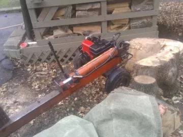

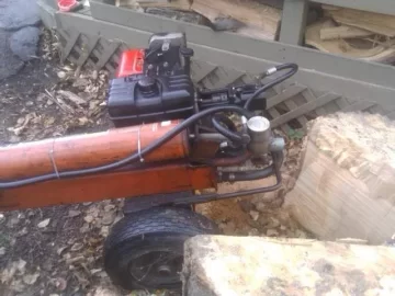

So here are the pix of the offending splitter. I'm not really too cranked up about repairing this thing. I'm tired of lifting logs and would really like a vertical/horizontal splitter. If you look at the last photo, it looks like this had been welded several times before. I've had it for 6-7 years and I'm sure the guy I bought it from had used it for many years before that. I'll bet this thing was 30 years old!

I always wondered how the little square tubers failed. My little splitter has more hydraulic mite than frame and flexes pretty good with a big round. It would only be a matter of time if I kept using it the way I was.

Looking at your pictures, I'd say that it would be possible to re-make that unit into an H/V w/o all that much trouble... The way I'd do it...
1. Pull off all the hydraulic stuff and set it aside - be sure to cap all connections to keep moisture and contaminants out...
2. Shop around scrapyards and other sources to find the following...
A. Suitable beam - 6x6 or heavier I-beam, maybe with an extra wear strip of steel on the top face, long enough for the cylinder plus splitting length, plus a couple inches extra...
B. Tank (or materials for it) - 4-5 gallon capacity minimum, probably sized to fit space between existing box beam and wheel on side opposite engine.
C. Big plate of 2" thick steel for base plate.
D. Steel suitable for making wedge carriage
E. Light weight utility trailer tongue w/ jack stand, coupler, etc. (may be able to salvage some of this from old splitter)
3. Build up beam w/ baseplate on bottom, cylinder mounting on top (no need to worry about wedge for now)
4. Cut old box beam / tank off on each end flush w/ existing running gear platform.
5. Put a hinge on top rear corner of box beam, and attach to new beam so that it sits right in vertical mode.
6. Attach trailer tongue to other end of running gear at height that will give a level ride for the splitter when hooked to an average tow vehicle. Put spacers on tongue to support beam top end when horizontal, and provide for way to lock it in that position.
7. Mount tank where it will not be in way...
8. Put hydraulic gear back on, make wedge carriage, etc.

Being on a fixed income and having a welder I would rebuild, repair, etc. Lots of money saved to spend else-ware.
I would probably fix it too. But I like fixing stuff. I would patch the tank and put a reinforcement on top to prevent it from happening again.
