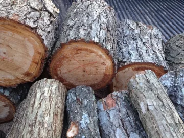

Sure it is:-) I use a piece of pre-measured pvc pipe to mark my cuts. While cutting rounds I keep a marker between my teeth to mark the bottoms. I hand split in my splitting area and knowing which ends are the bottoms makes it easier to split. See the mark on some pecan I cut yesterday.

Sure it is:) I use a piece of pre-measured pvc pipe to mark my cuts. While cutting rounds I keep a marker between my teeth to mark the bottoms. I hand split in my splitting area and knowing which ends are the bottoms makes it easier to split. See the mark on some pecan I cut yesterday.
I've never heard that splitting from the bottom is easier but I'm sure if you hand split wood you learn the right way and the wrong way after some time.
