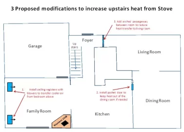

Currently I'm using a box fan at kitchen/family room border blowing into family room which is working pretty
well to make it comfy upstairs. I want to consider a more permanent solution though. Attached is my floor
plan with 3 proposed modifications to improve upstairs heat from the stove. I checked with fire marshal and
with local building code and installing the ceiling registers is fine. They'll be blowing air down into the room.
What do you think about this setup? Any suggestions?
Thanks,
Steve
Thanks,
Steve
