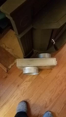

Install day was the Saturday before Thanksgiving. They showed up early 10 am and brought insulation so that was a good sign. They proceeded to do their thing and suddenly there was an issue and needed a different adapter due to the depth of my flue even though I had provided the dealer with all my fireplace measurements. So they left to get adapter. Of course that adapter didn't work so they left again to do a gas fireplace install in the next town. Then I get a phone call that an Uber driver is dropping off another part and they will be back later to finish the installation. The Uber driver dropped off an offset adapter (see picture). They returned at 4 pm and proceeded to continue the install. As they got closer to finishing the install I asked about the block off plate. They acted as if they had no idea what I was talking about. I told them that I didn't want them to finish the install without the block off plate so they were told to stop working.

So did they insulate the liner? I can't stand those offset adapters. They can work if you have enough height to overcome the loss in draft

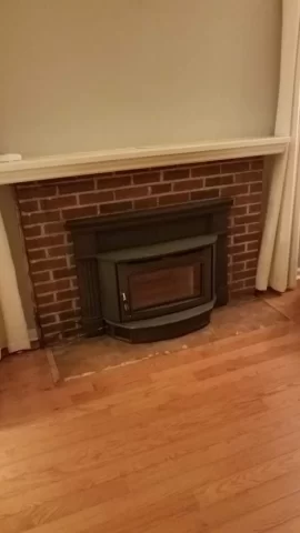

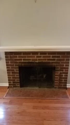

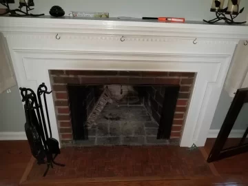

Some before and after

No they did not insulate the liner, said it wasn't necessary. At least I won the block off plate battle.
Did they check to see if your chimney has the required clearances?
I had the mantle surround removed to the clearances in the manual. I'm sure they did not check to see if my chimney had required clearances.
Then how did they know you done require insulation? I can all but garantee you do need insulation to meet code

You shouldnt have creosote buildup that low to affect the offset adapter unless you burn seriously chronically wrong. When it gets cleaned you will have to adequately vacuum out the fallen debris though. Shouldnt be a problem if you remember to do it.
The other thing that could put creosote in that offset adapter is if anyone ever, for any reason... sweeps the chimney.
What in the world. How are you supposed to clean that out? (I am sure @bholler knows!)
I could clean it if it was on my stove, but I can actually stick my hand in the flue collar from the front on my stove. I doubt that's true of everyone's stove.
Have you ever cleaned an insert with one of these offset adapters in? They are a real pita.
Reactions: moresnow
… Have you ever cleaned an insert with one of these offset adapters in? They are a real pita …
That's what my chimney guy said, too.
I measured where my insert opening is and saw that it offset from where the liner would drop down. I bought 15-degree and 30-degree adapters, to see if he wanted to use them. He used the 30-degree adapter.
Reactions: Nigel459
I made a specialized snorkel for cleaning the intakes on the newer gas fired water heaters. I am sure that something could be devised to clean the fallen creosote debris. It would just be laying there. Wouldnt be stuck unless the stove was fired after a sweep. Maybe stick a leaf blower on the top of the chimney and blast it out....I'M KIDDING!!!!! dont try it. LOL
