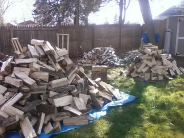

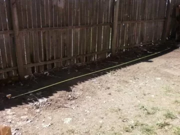

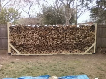

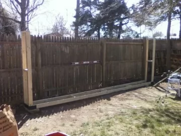

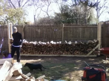

With a pending wood insert purchase coming next month, I've decided to get to my firewood stacked. Using steel brackets I purchased on-line and lumber from the big box store, I easily built two, inexpensive 16x1x6 racks. Each rack will hold a little over 1 cord.

Nice, is it free standing or connected to the fence?
I may be wrong, but isn't 16X1X6 only .75 of a cord?
that looks like what i wanna do, but only with pallet flooring.
Trailmaker: It is free standing.
Brianbeech: Mathematically, yes. However, those are the dimensions of the rack, not the firewood. My splits range from 12" anywhere to 20". Using 16x1.5(16" average splits)x6 I get 144 cubic feet, a little over 128 cubic feet (cord).
Where did you get the brackets?

That looks really good Rcrozier. Perhaps the only thing different I would have done was to stack that older wood at the top of the stack to use it first.

Are the bottom 2X4s treated wood?
Very nice, Good job!
0.975 Cord actually ;-) It looks like you have some spacers on the ground otherwise that wood would rot real last in our area.

I have the same setup ,I have 8 racks 2 rows of 4 back to back with 2 feet between them the wood is at least 6 feet tall,I cover the top and come down the sides about 1 foot best way yet to keep wood for the long haul. I use stack it brackets to hold the 2x4's together. Nice setup.
You guys are right. Okay, so it holds just about a cord depending on split length. I'm good with that. I ordered the brackets through Ace Hardware. See pic. You can search their website. Type in Hy-C Log Rack Kit. All of the lumber used is PT. Dennis, the darker wood (swamp maple/right most pile) was split just a couple of weeks before construction of the rack. It is also dark because of the rain. It however seasoned as rounds in my neighbors yard for almost a year and a half. The ash (large left most pile) had been split at least a year ago. I had it stacked and lightly covered. The back pile is birch which is at the bottom of the rack.
