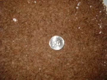

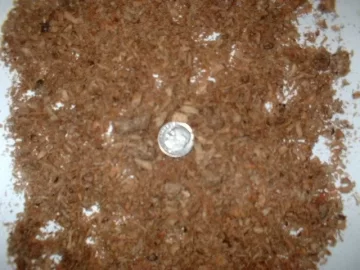

The pictures I have posted show the results of the water test I did last weekend. The picture with the dime heads up is Future Fuel II I purchased at Home Depot. I had to clean the burn pot twice a forty pound bag and came as close to a burn back as I ever want to.
Those pellets soaked in water for twenty minutes and did not dissolve. I returned the whole ton and bought a ton of penningtons.
The Penningtons did not get unloaded from my truck without having a water test done on them. It was the consistency of corn meal and they dissolved within two minutes.
Do this test on your pellets. Then return them. If your supplier balks then contact the Attorney Generals office.
The pellet producers are passing off standard, industrial, and animal bedding grades off as premium grade.
For whatever reason.
These stoves require PREMIUM GRADE PELLETS. By selling us something less they are going to cause hopper fires and large insurance claims. The result will be the insurance companies will not insure a home with a pellet stove. End of industry.
This is the same thing as passing off bunker C oil off as Kerosene.
Do some tests and return those pellets. Test the replacement pellets before accepting them.
With premium grade you will not experience this.
