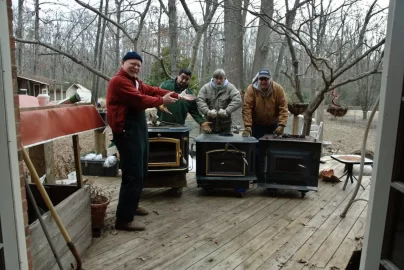

moving a 600lb woodstove
My brother and some husky friends is how I did it. Twice. Good story on why there are 3 stoves there. I'll start a thread sometime. [Hearth.com] moving a 600lb woodstove

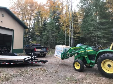

The day my Osburn 3500 insert arrived, my neighbor loaned me his tractor and I borrowed a 4 wheel dolly from the landlord where my office is who used to be in the moving business.
Put a couple 4X4s on the dolly which then sat just slightly higher than the level of the hearth. I was able to get the old Dutchwest stove onto the dolly by lifting one side at a time and sliding it forward that way until it was on the dolly. Easily wheeled it across the living room and to the front door. Had to lift one end of the dolly at a time and pull/push to get it over the raised threshold onto the front porch. There are 3 steps down from the front porch, but I was able to just pick the stove off the dolly on the porch with the forks on the tractor so didn't have to deal with the steps. When the new stove arrived the truck driver was able to back right up to the concrete pad outside my garage door and using his lift gate and pallet jack he lowered the stove (in crate on pallet) down and wheeled it into my garage. When the weather improves and the snow melts, I'll borrow the neighbor's tractor again and do the same process in reverse to get the new stove in the house.
