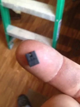

You might want to include a pic of said small black thing.. it could be lots of things.

Says amp on it noticed one of my blue vac had a good size crack in the end fixed that now taller flame and more heat on 9 still not sure what that little black thing is though.

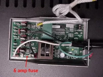

Top right hand corner in the picture. See the little wire going across the black box things with a screw ...thats the thermostat jumper

Found the jumper way down on the bottom! So I don't think it's that no real difference in flame from 1-9 no real heat difference either?
That jumper belongs on the board somewhere.. just need to figure out where it goes
idk.. dont really see anything like that on my panel.
Been a while since i had mine out and cant get to easily to look.. maybe the boards dont have them.
There is one of these blocks that came with the new smart stove that I bought two months ago . Talk to a tech at England stoves . He said that it was taped inside the control panel ,for use by owners . When you call england stoves for help they say they can tell you how to use it to run diagnostics on stove.

Looks like a circuit board jumper. It sits on two small pins to complete one circuit or another....
