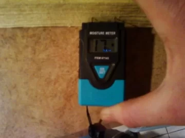

Here is a piece of ash .edited out the pos.misinformation about the ash split.

17% mc after 2 months on that ash!! Was it live or dead when cut? I surprised it's that low...the ash I'm currently cutting is 39% green.

I'm thinking that is not a fresh split or the wood had been dead for a long time.
Late fall, A tree service was taking down a neighbors ash trees and knocked on my door and asked me if I wanted it. I said sure and within minutes a constant parade of wheelbarrows full of logs went in my backyard. To be honest, Don't have a clue. It looked winter dead to me but. I thought it was alive b/c those trees had leaves on it in the summer. When I cut some of the rounds(b/c log length was 22-24") It smelled fresh from what I remember.
And Hearth peeps say ash drys out pretty quick. And in the late Fall the amount of water going through that tree is far less then right now. If I am wrong, please correct me.

F&N, is that a freshly split surface you were measuring in the photo, or did you just stick the prongs into the outside? Makes a big difference. You should grab a few more pieces and split them and measure right away in the center of the fresh face. If you did that already and got those results, your meter is defective or you are blessed with extraordinary drying conditions. BTW, I have the same meter and it seems accurate enough for the purpose of firewood testing. I didn't think that would be the case, but it held up well against a much more rigorous method of determining moisture content, so I'm a cautious believer... at least in my own meter.

Mine is a 12 dollar meter, not a $500.00 one . yes fresh split. inside middle measure. Could also be mine are split on the small side to begin with. If I throw in (the EM-42) anything bigger then say a 3"split, I have put out the fire within 45 minutes guarenteed.
