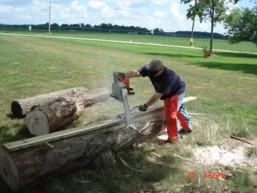

Mini mills suck! Mill the top off 1/4 spin Thaduuu!

If you have a table saw with some hp chaulk line it and free hand the line is much better than a mini mill can do!
