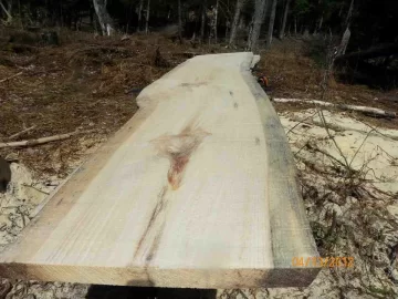

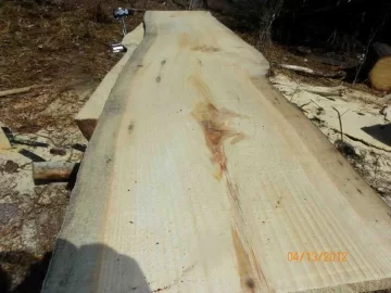

89cc, plus it's ported...I'm sure it would, how many cc's is it?
zap

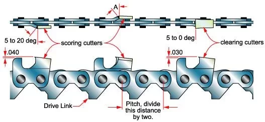

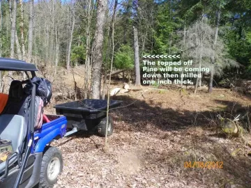

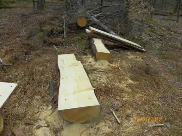

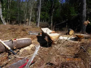

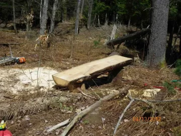

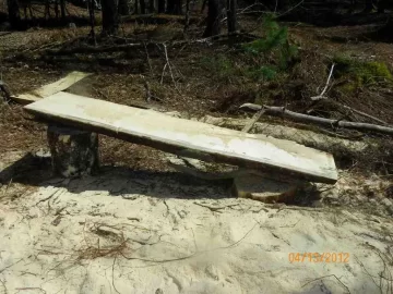

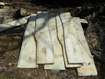

Yes, it worked out pretty good, had to go back for the hi-lift jack but it was worth it. Near the end of last year I bought some Woodland Pro Ripping chain, it's different from Carelton's ripping chain, that was the chain I grabbed for the 28 inch bar so I could drop the topped off pine.
