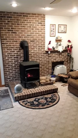

Prior to DVL installation.

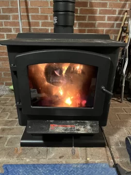

With DVL

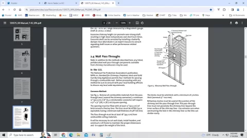

Jotul pic. So picture your/mine brick hearth wall in front of the 32 x 32 thimble surround. Hopefully your father and the mason constructed it that way.
