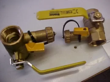

Install the HX with those clever Webstone valves on both sides. This allows you to connect a couple wash machine hoses and wash, backwash or run a cleaner through it.
Note the delta t when installed and as time goes by to help determine when a cleaning is needed.

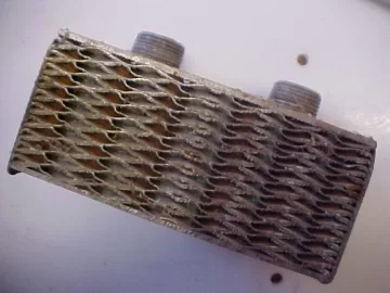

Here is an example of that valve. Also a plate HX I cut apart to see inside. This had been on a solar DHW system for 16 years.

That HX looks pretty good for 16 years of use. Was it cleaned regularly? How long did it take you to cut it apart? ;-P
