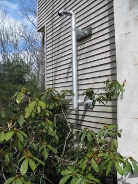

Pellet stoves operate much differently than wood stoves. Pellets have a very low moisture content. Where wood, if not seasoned properly, has lots of moisture. So a stove burning wet wood, with low flue temps will have conditions for Creosote to condense out and form in yout chimney.
Burning a pellet stove on Low, with pellets (normal moisture content), will only create creosote in rare conditions (some stoves differ here). Your Quad burns at a good rate with high enough temps to not worry.
What is your vent set up? How much horizontal and how much.vertical? Is it 3" or 4" vent? This will play a part on whether the conditions exist and also your fuel? Do you store your fuel indoors? Outdoors? Covered? Not?
Courtney: I had a service tech clean pellet stove after the first winter in use. After that I have done all service myself. Clean the inside, ash traps, vac the hopper, vac the blower as they collect pet hair, and of course I clean the vent with the lint eater after each ton. Then follow up with the leaf blower (do a search lots of great videos) just make sure your neighbors are not in their yard having a picnic when you do this. I use damp rid in the firebox during summer and cap the exhaust outside to keep the humidity of the summer from rusting the stove. I have had stove for 3 winters now and no major problems looking forward to many more warm winters.
