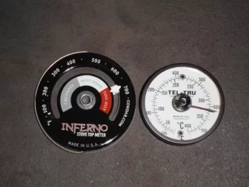

After running a TelTru next to the Condar I can say that the Condar does pretty good for the price. (The difference in the pic is actually a temp difference on the stove and was the same when I swapped them).

I've got an Englander 17-VL. It has an air circulation gap under the top, so the owner's manual says to put the thermometer on the front above the door. Problem is that there is only about 1-1/4 of space there for the thermometer, and the Inferno's diameter is 2.5 inches. Also, the Inferno indicates an optimum range between 400 and 650 degrees, but my owner's manual says 350 to 600 is better, and defines 650 as a damaging over-fire.
