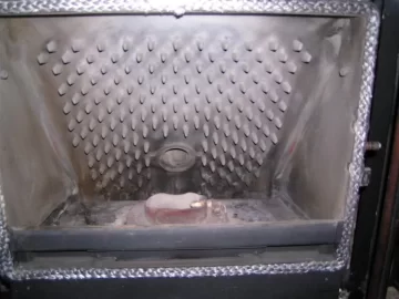

After seeing that video on the M55's baffle I am not at all impressed with that setup.
I guess I am just spoiled with my Quad MT Vernon AE's easy baffle removal and access to the heat exchanger for cleaning, flip and remove the 2 side locks, lift the baffle out and you find the heat exchanger.
