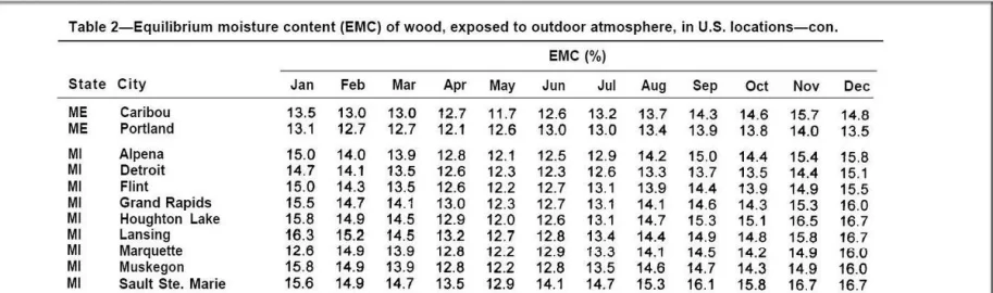

I'd say in NW ohio it won't go under 12% if outside.

I've had some measure 12% that was cut standing dead, and stored under roof for 2 years. I don't think it can get much below that without some "help", at least in my area.
