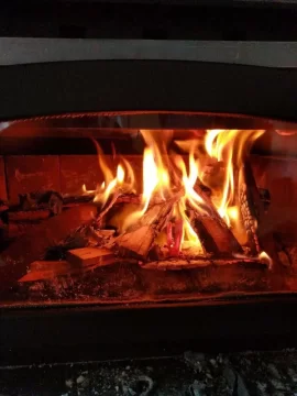

Do you find that you need to use the flue damper all the time, like whenever you have a burn going? If that was the case, I'd probably follow the procedure I outlined yesterday, except that I'd adjust the primary air pretty fast to where you want it to end up, and then start adjusting the flue damper incrementally the way I outlined yesterday. I really like the set up you have for monitoring your stove top temps with the digital read out and thermocouple.... I have the same sort of set up (digital readout and thermocouple) but I use it to monitor my flue temps, and that's what I use to watch the burn and figure out when it's time to turn down the air (whether primary, or with the flue damper).... Anyways, keep on burning because practise makes perfect, and you'll certainly get there eventually; I'd say you're well on your way to getting there already.....
