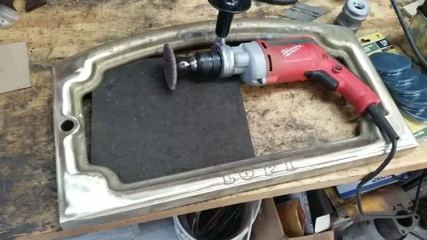

I took the door apart yesterday to polish the brass. There is some pretty deep corrosion on it. What's the best way to polish it? Brasso won't cut it until I get the heavy corrosion off.

If it is really heavy scotch brite or steel wool will work. We have had ones that were bad enough we had to start with sandpaper. If it is plated you need to be carefull not to take to much off
I tried red scotchbrite and it wouldn't cut it. Do you think a scotchbrite drill pad would work?

Yes i am a sweep so i work on lots of stoves. Is your door plated or is it solid? If it is solid you pretty much cango as aggressive as you want. Then just step up in grit till you get to a point you can polish it again. If it is plated and corroded really bad there may be nothing you can do but scuff it and paint it
The door is solid so it is possible to get the corrosion off. I'll try a scotchbrite drill pad first. I have a muslin wheel that I can use if I like when I get down to the finer grits.

Yeah if it is solid you will be able to clean it up just fine. I actually prefer the satin look of just using white scotchbrite as the final. But that is just my taste
I've done a little bit of metal polishing on my motorcycle but it's been a long time. I'll look for some pads to use with my drill. Thanks for the advice.

I bought a set of Rollock Scotchbrite pads and finished the brass door. Midway through the first pass I thought to take a picture. This is what it looked like:

The corrosion on the top of the door is what the whole thing looked like.
First pass complete:

I put a muslin wheel in my drill press and polished the door with polishing compound. The light was poor when I took this picture but you will get an idea of what it looked like:
