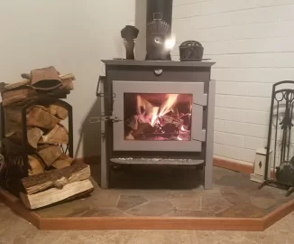

I paid $2300 for my Woodstock Ideal Steel, and freight was 300 or 400 I think more for the 2600 mile trip from New England to Reno, Nevada.
I love the stove and it's currently burning as I write this. Had it for 3 years now and it's a great heater for my 2300 square foot 2 story house from the daylight basement.
Definitely a stove to look at in my opinion.
