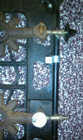

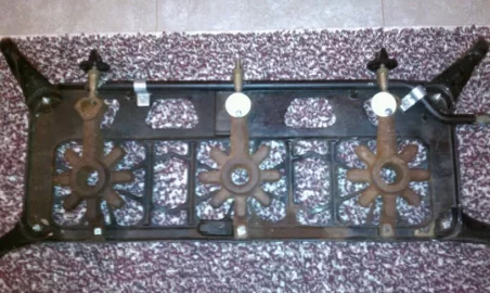

Was given this stove and it is missing a couple of parts. Small metal circle on the one burner and a handle. Anyone know where I can pick up these parts? What is the purpose of the small metal circle? The brand name is Superb.

It looks like they are adjustable to be able to mix air in to make them burn they way you want them to. i would just cut one out of metal if I were you.
I tore the stove all apart, cleaned it, and put it back together. I hooked it up to the new hose and regulator and a newly filled 20# propane tank.
It lights right up. Using just one burner it only gives me tiny little blue flames maybe only 1/2 inch tall and lazy. There doesn't seem to be much pressure.
Any ideas?
Is this the correct regulator for this stove? It says it is "low pressure".
http://www.northerntool.com/shop/tools/product_53127_53127
The holes in the burner units are rather large. A wooden match won't fit inside one but almost.
