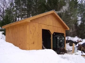

Here is my new wood shed 14 by 20 and 7-8 feet inside .
Very nice job designing and building your wood shed! It looks great! The money spent building it is offset by the aggravation of blown off and ripped tarps and wet firewood...
Ray
