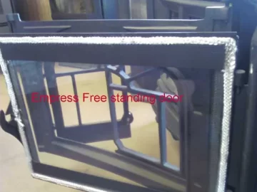

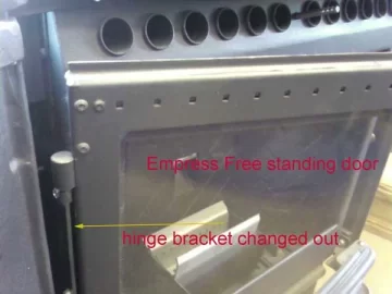

here is photos of the new style door.
  • [Hearth.com] Looking for Enviro Empress Parts
