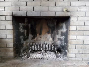

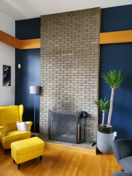

I have a fireplace I love to use but would like to add an insert to get some actual heat.
The small firebox is making it difficult to find a contemporary looking insert with a larger viewing area.
Here are the specs :
Front width: 34"
Front height: 26"
Depth bottom: 17"
Depth top: 14"
Back width bottom: 20"
Back width top : 21"
Back height: 26"
I have also attached two pictures.
I am considering the Regency ci2700 (it should fit and it has a large viewing area) but since this is not our main source of heat, it seems over kill. Also, the number of posts I read about the learning curve associated with catalytic stoves is a bit discouraging.
I love the look of the Stûv 6 inserts but getting information on them from local dealers is like pulling teeth...
Any recommendation considering I want (1) to enjoy the ambiance a fire creates,
(2) get more heat than with our current fireplace without needing to replace our main source of heat.?
Thanks in advance for any suggestions!
