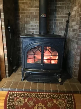

Any opinions on this old mill stove. A guy on fbook marketplace is asking $550 for it. looks to be in good shape. View attachment 254612View attachment 254613
That is a coal stove that "can" burn wood, but not as efficiently as coal.

Quality stove. If it's in good shape, I would go for that over a "value" stove. Parts are all replaceable, if needed. I liked the "floating firebox" concept. I got a PE T5 for my SIL recently..same box as the Super.
I think the 27 was about 1800 new, without any options. Depending on how old it is, you might be able to get them to bite for 1000. Can you get any pics? The metal tag on the stove (which I think has the date it was made,) the secondary baffle in the top of the box? Check the stove body corners by the door for cracks. Talk to the person that ran it if you can, ask how their procedure for starting a fire in it, and see if it sounds like they are knowledgeable, and ask if it was ever over-fired. If it's fairly new, or they didn't use it much, or they were a conscientious operator, could be a great deal.
I got the Super 27 for $900. Stove didnt have 1/3 cord of wood burned through it. Stove looks brand new in and out. I couldnt believe he accepted my offer and it was only a 1 hour drive to pick it up.
Nice move, you'll like it. >> As mentioned, the bare block walls will soak up a lot of heat. What is the square footage upstairs that you hope to heat? Do the stairs come up in the center of that area?
Congratulations. Sounds like you stole that. It's a good heater.
1/3 retail is a steal for a used stove in good shape, but I'd pay what he did in a heartbeat, for a stove used that little. Nice get! ==c
