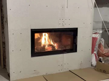

Hi, I'm a new member here and just chiming in to say that there are a few double-sided inserts out there. I recently had one installed, the Morso S120-21. It has glass both sides but only loads on one side. (The other side does open via some rather fiddly latches for cleaning.)
My setup was that we added an extension onto the side of the house so the existing fireplace which was on the outside wall was now on the dividing wall. On the new side is a TV room/snug, while the old part of the house is now an open plan space. So we knocked through the back of the fireplace and
My house isn't that big and I live in the UK so our winters aren't very cold, so it might not work for bigger US houses and colder weather unless it's just for aesthetics rather than a main heat source, but it does chuck out plenty of heat (10 kW).
That sounds awesome! Can you post some pics?
The installation is not quite finished yet but here you go:
The main room will have a flush finish with a skim over the concrete board. For now it’s just bare boards but I can post some pics once it is finished.

The “back” of the fire is in the snug and at the weekend I used brick slips over the existing brick wall (old house exterior) and around the alcove which was boarded out. Because of the depth of the house wall it couldn’t be flush on both sides so it’s recessed by about five inches.
Before the brick:
[Hearth.com] Looking for a Double SidedWood Burning fireplace
And after (still to be plastered above the brick and a mantle shelf to be added).
The air supply for the stove comes up from underneath. You can install with vents in the wall but I got the builders to lay an air supply pipe under the floor of the extension leading to an airbrick in the outside wall so the fire draws air from outside rather than sucking in indoor air.
