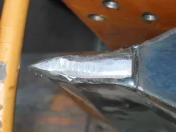

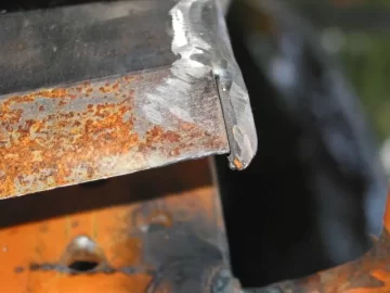

Not a Husky, but I've made a couple of minor mods to my HF splitters work area..
1. My wedge was made at a slight angle to the beam, where the beam end is closer to the foot than the outer end - this causes some rounds to slide on the wedge as it comes down and pop out rather than splitting. I welded a sort of "tooth" on the outer end of the wedge so that the point would stick into the round and anchor it as the rest of the wedge came down... Haven't had much to split since I did this, but it seems to help, although I should have made it a bit longer as it doesn't quite stick out far enough.

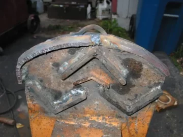

2. In the same way, I found some rounds had a tendency to slide off the foot rather than splitting. Stock the foot only has one little "V" piece of angle welded to it in order to provide traction and keep the round from sliding. I took a scrap of 2" angle iron and made some ~3/8" long slices off it to create some more "arrows" and welded them to the foot, along with some 1/4" flat stock scrap that I welded around the perimeter of the foot (easy enough, tack it at one end, then as you weld it gets hot enough to easily hammer into shape around the foot) This was a BIG improvement, as it supplies enough "traction" that the rounds can't slide around on the base when the wedge hits them, which is a real help on the rounds that aren't cut perfectly square, or have bends in them...

Bringing this one back up - finally downloaded the camera, and got the pix sorted out - here are three that show the improvements I mentioned...
The first two show the "tooth" that I added to the outside edge of the wedge - It seems to help, but I really should have made it a little longer so that it would go into the round sooner. Right now it hits a round at about the same time as the center of the wedge, so the round has a chance to start tilting before the tooth gets into it to stop the movement.
The third shot shows the added steel on the base. The little "V" in the center is the stock bit, everything else I added. If I find that if the added stuff doesn't bite in well, I might take an angle grinder to the added bits and make them more "pointy" and possibly serrate them a bit...

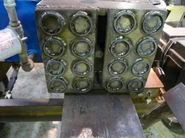

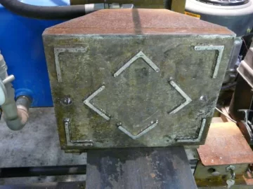

I'll add what I have done to my splitter for traction on logs.
The first pic is my ram face with some angles laid out in a pattern. They work well. I don't think I have had a log I couldn't grab.
The second pic is my elm extension with the pipe slices. The pipe slices are almost too effective. They sometimes grab the wood well enough to pull it back when the ram returns.
Don
