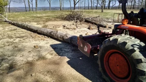

I got the Logrite 25" skidding tongs from Logrite years ago: (broken link removed to http://www.logrite.com/store/Item/logtongs)
I've pulled some pretty big trees with it on my tractor, it's held up well.
Latest tree was a medium Poplar, pulled it about 150 yards or so a couple days ago. The tractor grunted lifting it with the 3ph.
