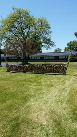

I just stacked what was left of a cord I had this morning...it's my first stack like this. Any ideas how much wood that is?
And how high can I go on this stack? It feels like if I drive into it might go over!

Buy the log load, and stop and buy the facecords, they are the most honest way to buy wood. They are premeasured. Its just you have to load and off load it, only a labor drawback. But if you have kids bully them into doing it. $50.00 is a great deal.
Once you get a good supply going then you can pick and choose.
I use cement blocks and poles too but I wire tie the tops so the uprights dont spread out like that. If you go up 4 1/2 feet you will be able to measure cordage better. You can measure in 4' x 8' increments.
Looks like about 2 facecords.
yeah that's what I figured too....but I am more concerned with storage space! I was hoping to go 6' high on each pile but there already is a lot of weight on their as evidenced by the ties bending. I either put more blocks under there or keep it at 4' probably....I figured at 6' high each rack will hold 1.5 cords though which is kind of nice!
Place a tie end to end to limit the spread and fill it until it starts to feel less stable. Some people put an end to end tie every couple of feet just to make the stack a bit more stable. As you stack on top of those ties it tends to tighten up a bit.
If you don't want the ends to lean out you need something and a simple tie from end to end will keep the ends from spreading. What you actually decide to do is up to you. Even a 1/4 inch rope near the top should be stout enough to keep those ends from spreading much.
The idea of the intermediate ties is to give the wood splits a stable starting point every few rows. It still is up to you how you use the information that I pass along.
Ive had good luck with cribbing the ends. It looks nice and you wouldn't have to worry about it falling over, that or leave it like it is and dont stack to high. I keep my stacks on pallets and keep them to around 4-4.5 feet otherwise they get to unstable.
