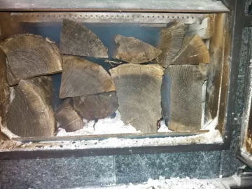

From a few nights ago the big rock is ready to roll.

I have lusted to burn in a Manny for ten years. Damnit! That has to be one incredible wood stove.
I'm impressed with the heat. The last 2 weeks were the coldest we've had with it. Ad it would keep the stove room hot with 2 full loads and a small one.
I would have one in my fireplace but with what that sucker weighs I would probably have it sitting demolished in the basement some night filled with burning wood. When the burn started on the floor above. !!!
Envy. Sometimes I wish I could load North -South like that.
