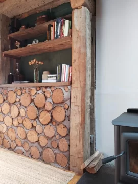

That looks great. I think you are going to love this setup. The house looks interesting too. Is it all log?
Just the 1st floor, built in 1980. He did 3 things that weren't particularly correct:
1. Used fresh (green) hardwood
2. Didn't split the logs
3. Didn't take off the bark
...but it's held up reasonably well and, although far from perfect, has a nice, rustic feel:
