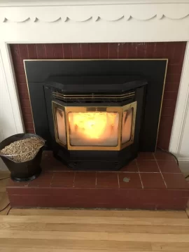

1. A brick fireplace hearth in the main living area, to replace the existing pellet stove. It has a brick chimney original to the 1957 house with a GoldenFlue masonry chimney lining added in the last 15 years.
![[Hearth.com] Like a game of Jenga heating a house in Maine... Where to put the Jotul F3CB and what other stove to buy? [Hearth.com] Like a game of Jenga heating a house in Maine... Where to put the Jotul F3CB and what other stove to buy?](https://www.hearth.com/talk/data/attachments/289/289079-04711c94c22156860ee89b02826b5782.jpg?hash=SfBcuQQT0O)

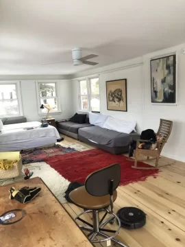

2. New install in a 350-square-foot sun porch that is drafty. It's kind of insulated, but not very well. It connects to the kitchen via an open doorway than will soon have an exterior-grade door installed. The stove will be operated with the door to the main living area open and closed. Its primary application is to keep the porch warm and its circuit of baseboard heaters off until the middle of the night. A space heater, essentially. We need to run the chimney up to the top of the second story, per code. The stove will go between the two pieces of art hanging on this wall:
![[Hearth.com] Like a game of Jenga heating a house in Maine... Where to put the Jotul F3CB and what other stove to buy? [Hearth.com] Like a game of Jenga heating a house in Maine... Where to put the Jotul F3CB and what other stove to buy?](https://www.hearth.com/talk/data/attachments/289/289077-f37069478aa35592805b7c8c3819a62a.jpg?hash=NFFlM8gPbT)

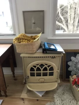

I got all excited looking at Craigslist, particularly given the shortages of new stoves, and bought a refurbished, rear-vented Jotul F3CB in ivory paint for the sun porch.
![[Hearth.com] Like a game of Jenga heating a house in Maine... Where to put the Jotul F3CB and what other stove to buy? [Hearth.com] Like a game of Jenga heating a house in Maine... Where to put the Jotul F3CB and what other stove to buy?](https://www.hearth.com/talk/data/attachments/289/289078-3ca0c02fe2481aecdd6887eab38dfa1f.jpg?hash=qoiwia6A4L)
My thinking was: It's too much stove for the space, but I could always just run small loads, and if the door to the kitchen was open and I got the air circulation right, at least some of its excess capacity could heat the main living area via that doorway. So now my question is: Should I stick with the F3CB for the sun porch, or recoup the $900 I paid for it and get the F602 or Morso?
