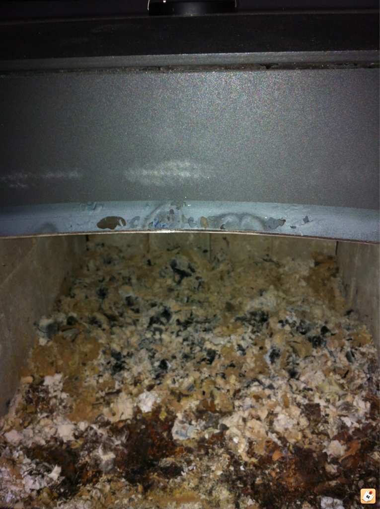

This is that paint I was talking about.
It's inside the door seal. Gets hot in there. It better be getting hot in there.

I have a Lennox grandview 300 new to me this burning season and have burning it for about a month now, most of you on the forum say that 700-750 stove top temps is normal burning in my manual it says once you reach 500 close the damper all the way as you are operating your appliance at too high of temperature, But if I do that won't that cause the stove temp to get a lot hotter because your keeping the heat in the stove and not let it go up the pipe? I have a prob flue temp gage and a stove top one and I have never seen my flue over 850 but have seen my stove top at 700 with the damper all the way closed so my question is is it over firing? And is this normal for the paint to be coming off the air wash baffle already?
