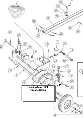

post a pic if you can close up so we can identify the connection type and the typical fixes.
Just called them, and they said it may have cracked due to overtighing at the factory. They do use pipe dope. He suggested heating it slowly.

Vice grips will make it even more difficult to take it off. They clamp the fitting even tighter & will cause future leaks.
"Mechanics" will "CRINGE" every-time they see someone with vice grips or channel locks pliers on hydraulic fittings (or about anything that a wrench will fit )
If you don't have the correct size wrenches, take it to a shop or buddy that does. Local garage may do it for free.
If you keep reefing on it with vice grips, you'll need a new hose too.
Use 2 wrenches, one on the fitting threaded into the pump, one on the hose fitting, position the wrenches so you can squeeze then together to loosen the hose fitting.
Be careful removing the fitting from the pump to not apply side force & break the pump mounting bracket.
Have a plug or cap ready to plug the ports to save hydraulic fluid.
I bet some good pipe dope, and/or thread tape will fix the leak.
