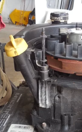

The naked stud.

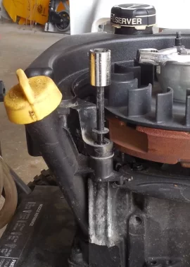

This is a socket that fit over the top to protect the threads for a few taps.

The naked stud.
