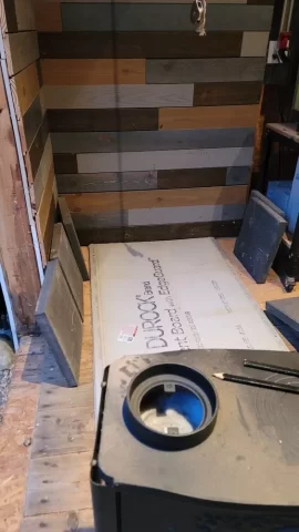

First time installing a wood stove and looking forward to the process. Its a Morso2B standard that will be used to heat a small 16x20 uninsulated woodshop.
Would love to check the sequence of layering the hearth which is going directly on wooden floor:
1. Micore300
2. Aluminum Flashing
2. Durarock 1/4"
3. Durarock 1/4"
4. Thinset [ Mapei Thinset Tile Mortar ]
5. 16x16 Patio Stone - 2 wide for a total width of 32"
The stove needs 6" on the left and right side of hearth and since the stove is 13" wide total width needed is 25".
Couple questions:
1. Do I need to screw in the Micore to the wood floor? Also given the weight of the Patio Stones, do I even need to screw in the Durarock? I'm not opposed to it and can use the BackerOn Rock On Cement board screws ( 1 5/8" ) on top of the final layer of Durarock at 8" spacing on center. Not sure if its overkill?
2. Did I mess up picking up the 1/4" durarock when I should have chosen the 1/2" version?
3. From what I've read, regular thinset is what is suggested. But since these are 1" thick patio stones, should I use something else? I'm not spacing the stones at all and plan on just running them 2 wide on the Durarock.
https://www.lowes.com/pd/MAPEI-Floor-Tile-50-lb-Gray-Thinset-Tile-Mortar/5013732043
