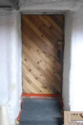

3rd Interior basement door to the garage, door is about five feet high.

No, you not reading this wrong, the two upper stories straddle and are attached to a six foot thick rubble stone foundation. This is not a conventional made from plans home, it was built by someone without plans or much knowledge of building. They built the foundation, added a chimney then built on two upper floors. The upper rooms of the house are attached to the subfloors with forged iron straps that attach to the structural beams. It's a strange way to build, and my neighbors interior walls are even thicker, they must have been built by the same person or persons. The houses date to before the 1820's, which is when they were likely sold for the first time.
Probably figured out they'd make a stand on your block if those crazy Americans ever invaded again!
Thank you for the pictures, Charlotte987! That's amazing. No, you haven't hijacked anything, conversations evolve and wander wonderfully sometimes. The only "solution" I'll try next winter are some tall curtains on the wall. Since the wall runs next to the stairs there's no room to build a bookshelf, although that would be a great looking, albeit, massive bookcase!
