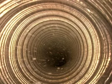

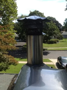

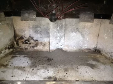

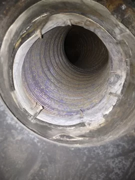

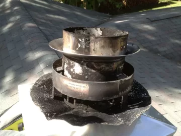

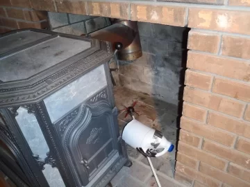

With the baffle out and stove completely apart, I took a trip to the local mason's yard and picked up two pieces of 1/4" split firebrick. I needed a top right corner brick above my baffle as it was cracked in half. I pulled out the ol' grinder and cut it to size. Before putting the stove together, it was time to give a final sweep. Soot Eater time. Took 5 min on the roof and then buttoned her up. She's ready to roll.
[Hearth.com] Last Sweep Before Burn Time (Pics) [Hearth.com] Last Sweep Before Burn Time (Pics) [Hearth.com] Last Sweep Before Burn Time (Pics) [Hearth.com] Last Sweep Before Burn Time (Pics)[Hearth.com] Last Sweep Before Burn Time (Pics) [Hearth.com] Last Sweep Before Burn Time (Pics) [Hearth.com] Last Sweep Before Burn Time (Pics) [Hearth.com] Last Sweep Before Burn Time (Pics) [Hearth.com] Last Sweep Before Burn Time (Pics)

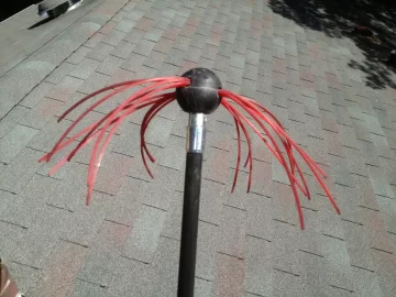

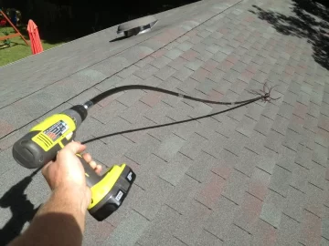

That's nice and clean. I think you are supposed to trim the sooteater whips to just a bit larger than the pipe diameter.
Cool. I am cleaning mine out with a sooteater for the first time this weekend. For a 6" round pipe the whips look like short stubs in comparison. More like in this pic by Lakeside:
That's what mine looks like. I need to try that bleach bottle trick. I've been using 6mil and duct tape and its a mess.

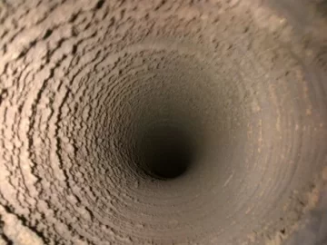

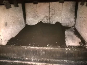

Wow that's all the buildup you had for a year of burning? It was my first year, but still I had a lot more when I did my sweep. The plastic Sooteater works well? I have the conventional wire brush on fiberglass poles. It worked ok, are there a lot of advantages?
[Hearth.com] Last Sweep Before Burn Time (Pics)[Hearth.com] Last Sweep Before Burn Time (Pics)[Hearth.com] Last Sweep Before Burn Time (Pics)
Flex liners tend to collect a bit more than the smooth pipe sections. Yours looks about what mine does after a whole season ( basement unit up the masonry chimney) My up stairs stove has very little( maybe 2 cups), but that's on Selkirk pipe and is smooth inside.

No, I swept it right after the season ended without removing the baffle. I wanted to totally clean the stove and inspect it before this burning season.
